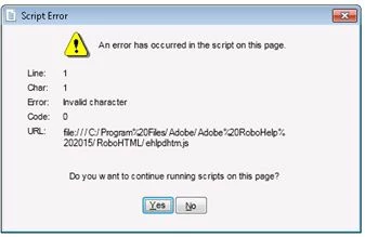

After converting an old project, when I open a topic select View Item, I receive this error:
Whether I select Yes or No, the topic opens but I can't select any of the drop-downs to see the content inside.  This doesn't seem to be a problem for the finished output after I generate the webhelpl, but I still need to be able to just view topics to see how they look.

Can you try running Tools > Update DHTML? Also, if there is a file ehlpdhtm.js in the root of your project (not output), please delete it. That should solve the issue in the preview.
If the issue persists, are you using any DHTML effects such as fade in/out on your pages?

I've tried that with no luck so far.  There was an ehlpdhtm.js file in the project, so I removed it, reopened the project, ran the Tools > Update DHTML, and still no luck.  I also tried it again in reverse order.
I'm not using any fade in or out effects, but I think at one time we did have one or two that had some effects, if that might matter.
