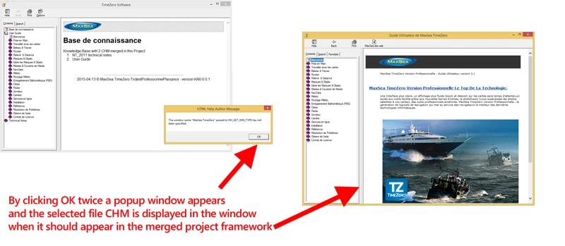

Error when clicking topic in merged project
I use the latest Robohelp version 11
I always have a message of the form "”The window name “xxxxxx” passed to HH_GET_WIN_TYPE has not been specified" appears even when you have set all your window definitions correctly ... then a secondary window appears which contains only the CHM selected as it is shown in picture below:(the left screenshot is the project that has 2 chm merged and the left screenshot of the selected chm)

AntoninMaxSea
Apr 15, 2015 2:30 PM UTC
Thanks a lot, after reading carefully and following step by step your doc I've resolved the trouble, different Window's names were used on each project and a file name of the chm also contained a underscore character.
