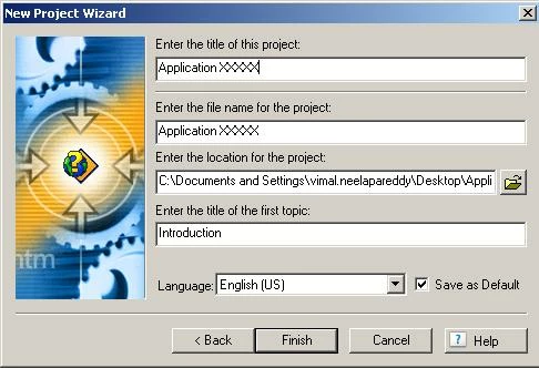

     When I open RoboHelp 8 and select Application Help or Blank Project, I start getting errors (I have tried all other options too with no luck).
Process:
Open RoboHelp 8
Select "Application Help" under "Create New"
On Clicking "Finish"
The following errors occur
And so on... It continues with a lot of other errors.
Any suggestion on how to open a new project with out these errors will be very much appreciated.

    You wouldn't necessarily be aware of the problems when installing. Have you specifically checked with your IT that they do not store your profile on the network. That bit is important.
    Then try http://www.grainge.org/pages/authoring/installing/installing.htm and see the Problem Installations section. One link helps with installs that have failed and the other removes installations more deeply than the programs own uninstall routine. You may need to install again for RevoUninstaller to work.
    I suggest you work with IT using either of the links.

    Peter,
              My Situation
         1. I am not on a network drive.
         2. I am an administration on this system and hence have all the permissions needed (As informed by my company's IT Help Desk Support)
    Talking about Installation problems. I did not have any installation problems while installing the application.
    Downloaded the file into a folder. Extracted it and installed it.
    Now, I am trying to uninstall it, i could'nt. I get a message that the program was uninstalled but the program still exists.
    I tried running the installation file and then removing it... Same problem
    I tried reparing the installation, Nothing happens.
    I am confused and so are the IT Help Desk folks. They say that everything is fine with the installation expcet for the facts that is wouldnt uninstall.
    Thanks
    Calcasmy.

    If you installed RoboHelp 8 with your own profile, did it have local admin rights attached? If not, uninstall and reinstall with local admin rights or get an IT admin to install it.
    Otherwise, try creating the project outside your profile. Create it in say C:\MyProject

         I tried doing that too. Infact, I am not able to open the *.xpj files under the samples too. It gives me the same error.
    I have not installed any updates or patches could that be a reason why i am not able to open. If so please suggest which patch or update I should install.

    If you cannot open the samples something is wrong with the installation. It could be permissions as I suggested or it could be that your profile is not local. If it is on a network drive, then any project you create within your profile, which is also where the samples will be located, will fail.
    I think you need to involve IT in this one.
