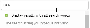

  • Some symbols are not valid searched "string"
    The problem is that we use some of them pretty often. It happens only if the symbol is not attached to a word. E.g.: J&R is valid - J & R is invalid
    They are valid if searched between Qutation marks
      • The most used by us is &, -, /, #, <, > and ±
Invalid
Valid
My guess on this is that the symbols and the words are not present in the search engine as valid "words" to be searched.
Any isight on this and the reason behind?

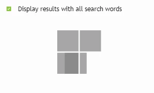

  • When string-searching is checkmarked in the options, we have an infinite loop that comes up and we have to push "Enter" again to get results.
