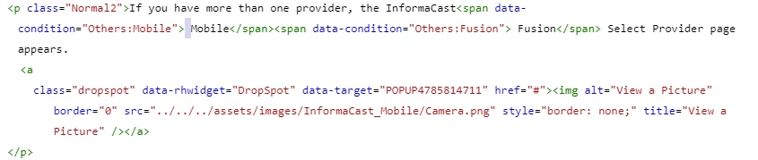

    The tags in the sentence that start with "If you have more than one provider..." do work how I intended (this problem doesn't affect all instances of the Mobile condition tag, just some).
    I've been trying to have the Mobile and Fusion instances include the space before them within the tag because I sometimes just copy and paste these all through a topic and when they fall at the end of a sentence, there isn't somehow an extra space before the period.

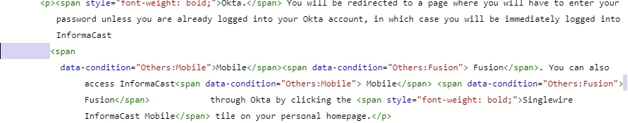

    The following picture shows the Source view from a condition tag that's working and you can see the space highlighted in blue:
    If, using the Okta code you also cited, I remove the space included with the tag and Mobile and put it instead after InformaCast (and not within the tag), save it, change views, it does work, which doesn't make any sense because then there should be an extra space between InformaCast and Fusion when that output is selected because the Fusion tag does have the space within it and is working as intended. Here's that code with the spacing highlighted in blue in two spots:
    Here's the output for Mobile:
    Here's the output for Fusion:
    There's no double space between InformaCast and Fusion, yet the code clearly shows a space after InformaCast (not included in a tag) and a space in the tag with Fusion.

    This is what you had in the topic. The space after InformaCast was included in the Mobile tagging.
    Note in source view there is no space between InformaCast and the span tag but there is one before Mobile within the tag.
    I changed that in source view so that there is a space after InformaCast and the span tag and no space between the end of the tag and Mobile. In author mode it looks like this and seems to work.
    Are you saying those changes do not work for you?
