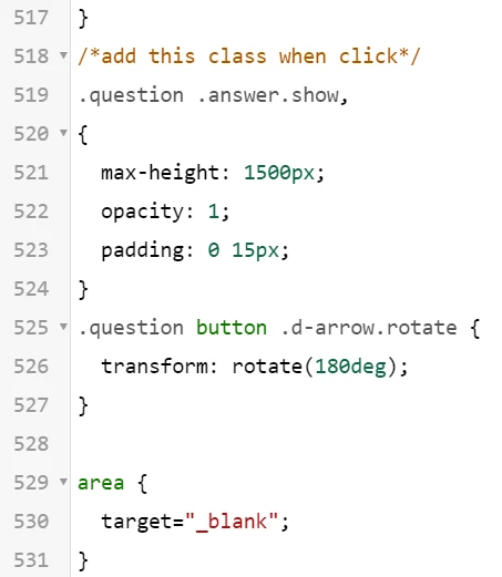

    WoutJacobsCorrect answer
    May 14, 2024 6:19 PM UTC
    Problem seems to be straightforward when looking at the images.
    area {
    target="_blank";
    This is not valid CSS. You cannot use the equal sign like that.
    Easy to test, just remove that piece of CSS and check again.

    May 15, 2024 7:26 AM UTC
    Oh gosh, it works !
    I just changed the equal sign by ":" and now, it works perfectly ! (It did that before not working at all haha but still).
    Thank you so much !

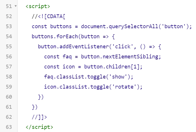

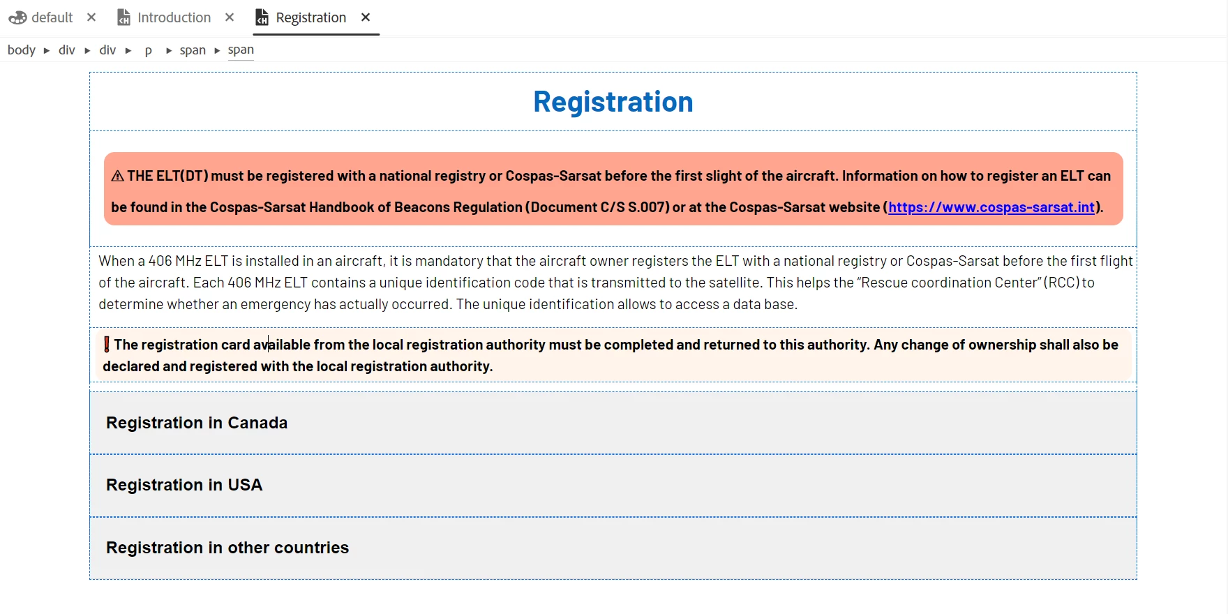

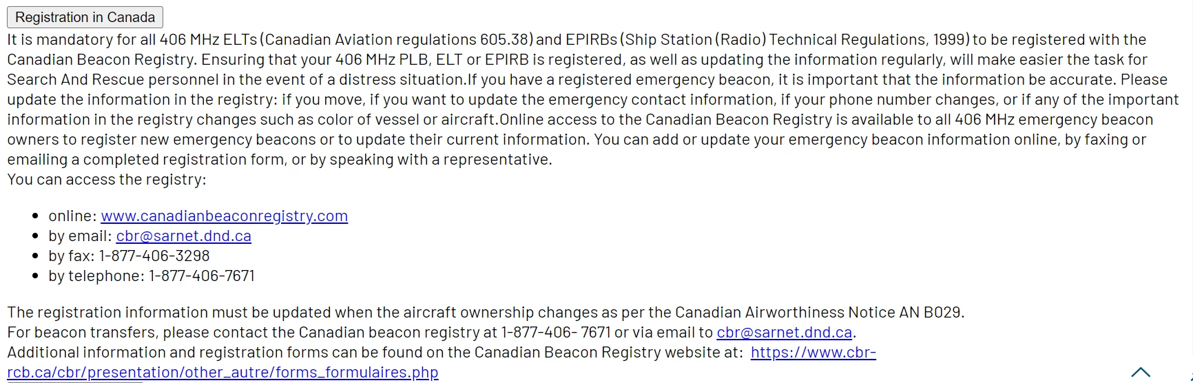

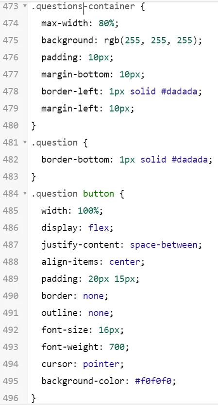

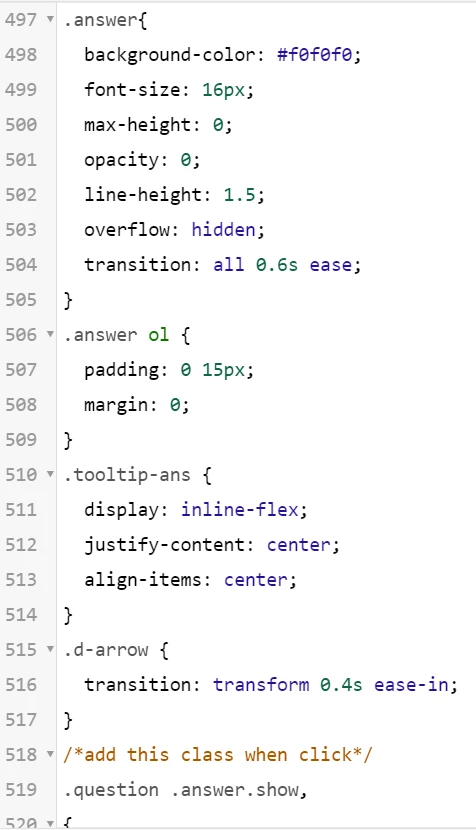

    May 14, 2024 8:09 AM UTC
    Hi again!
    • The message appeared when I clicked on my css file.
    To make sure it was not an error of templates changes, I used a new one untouched and it still doesn't work. I'll give you an exemple :
    My CSS and the results :
    The author view in Robohelp :
     The source view :
    The css view and the script I put directly in my topic :
    And this is the output :
     Before the failed message of the css, everything was working perfectly and the javascript was also working, it just happened like that, and I don't understand why. I also verified that I included my css in my topics and it's there.

    You've also got a typo in that first warning line - I think you want to say "first flight" not "first slight".
