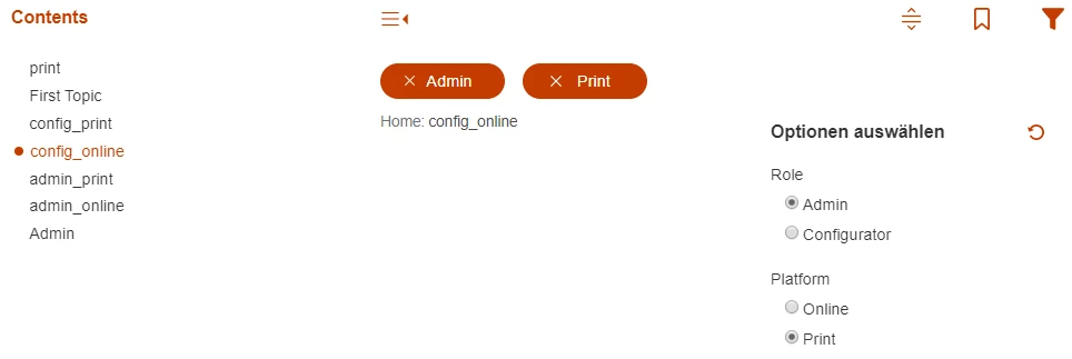

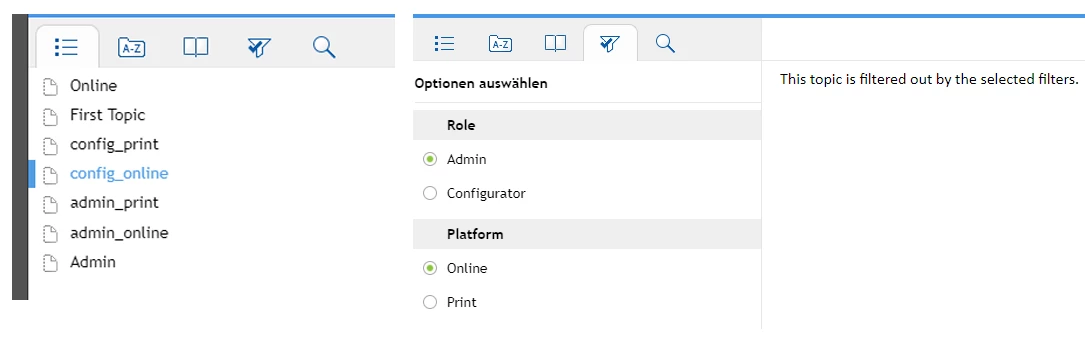

Probably it was a missunderstanding - I need it working for dynamic filters, not for different outputs.
I also created a test project were you can see the behaviour:
The titles shows, how the topics are tagged.
For example, how can it be that "config_online" is displayed although the filter "Print" is set. The topics "online" and "Configurator" are hidden, as expected. This looks to me, that the the filters are OR connected. I think "config_online" is displayed, because it is tagged with "Configurator" - the Plattform-tag doesn't have any effect on it.
These topics are contained in the project and output:
In the responsive output, the content filtering works, but in the toc the same behaviour (thats why I asked for the tagging in the toc):
