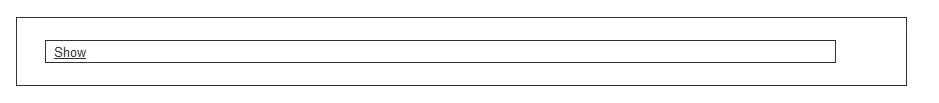

The search result links now work, which means the correct page displays and the word(s) are highlighted.  The only thing now is that at the top of the page (opened from the search results), the double-rectangle displays with  "Show" link above the breadcrumbs.  Clicking on the "Show" link displays the toolbar buttons in the content pane (and nothing else, no content).  It's partially fixed in that the search results links work, search words are highlighted, and Firefox doesn't hang. Just need to get rid of the show box.
Maybe I replaced the wrong information in the script?
