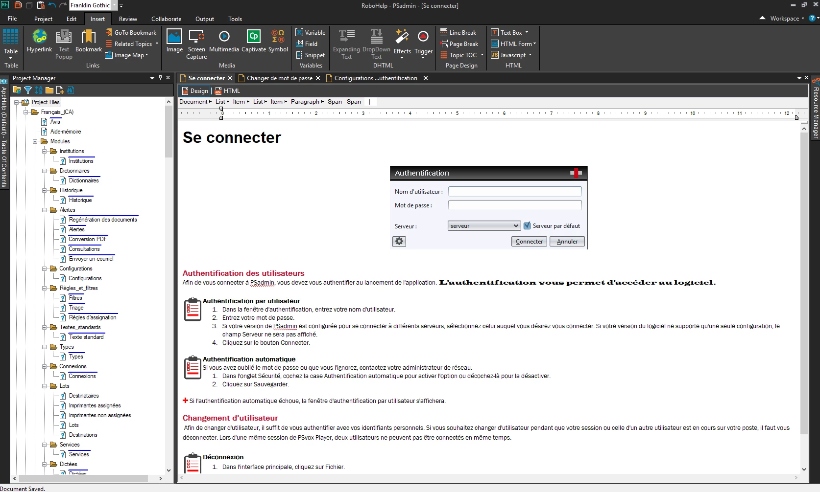

I cannot change the font in the Font change button on my customized ribbon. The font I selected doesn’t show up. It changes for a random font. At least, the Font change button in the Edit module stills work but it is disrupting my work a lot.This bug appeared randomly, suddenly.

Robohelp (2017).
I am confused because I've spend three hours with a very nice agent who fixed the problem yesterday. I finished my work, left my computer and Robohelp opened (in the same project), yet the problem is back this morning. I don't even understand how it can be back since I closed nothing.
If I select text and I change the font in the custom ribbon, which is very helpful, it changes to a random font. Here, I selected Franklin Gothic Medium and it went for Wide latin.
The agent and I verified I had the fonts I need installed on my computer.

Does the same happen if you change it in the Edit ribbon? I'm guessing it does but it's worth checking.
Again I doubt it is the issue but try closing the project and deleting the CPD file, then reopen the project. Does that affect things?
