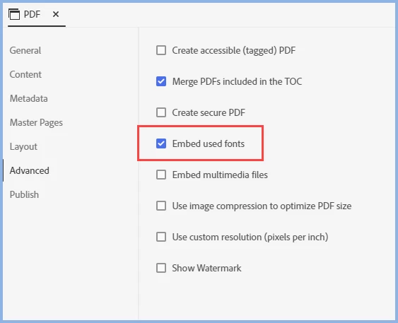

    Jul 20, 2020 9:16 PM UTC
    Hi Peter. No, it wasn't set in that particular project. I've tried that about a dozen times now, with no luck. Both in that project and two others. The font is picked up in the HTML5 preset - but not in PDF. Word isn't really required for my purposes.
    Curiously, ticking the 'Embed' option simply made the existing fonts bold, for some reason. I'm on with tech support now - will let you know.

    Jul 20, 2020 9:04 PM UTC
    In the project you sent me the check box I referred to was not checked as I had suggested trying.
    Initially I got the wrong font but then I realised I don't have the font you are using. I substituted another font and it work OK.
    Check that setting again please on all machines.

    Jul 20, 2020 3:47 PM UTC
    I've had this switched on all along. After returning to the project on my original machine - with RH 2020 - on the exact same project, that generates correctly. The same fonts are installed on both machines. I also tried it on a third machine, where it failed to recognise some fonts in the PDF export.
