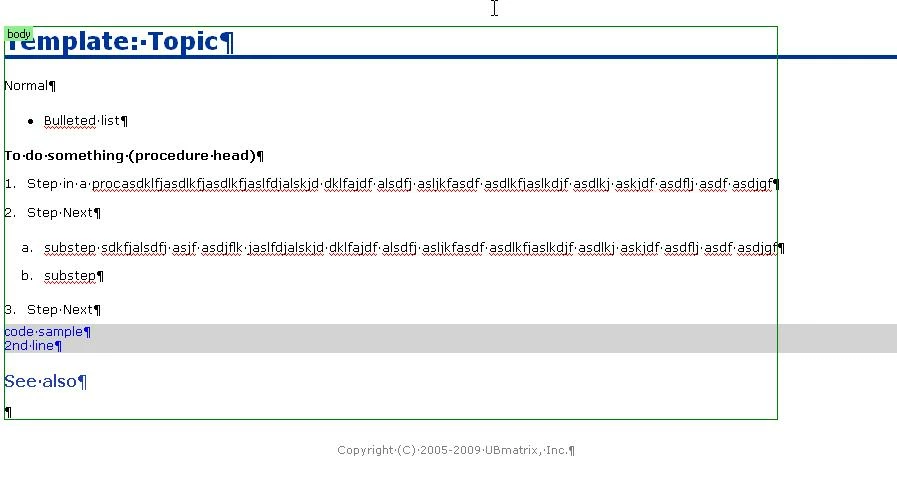

I have been using an .htt for quite awhile (several months) and was happy with the centered, font size 8, copyright notice in a muted gray.
This week, I noticed some topics sporting a wide black line that doesn't respect margins in place of that lovely footer.
So I checked the .htt, which still has a nice body/footer/header layout. I renamed the desired .htt, highlighted all topicsin the topics list, right clicked, and assigned it as the Master page. Cleared my published folder locations, and republished. Same ugly black line.
What happened?
RH 8, project was upgraded from RH 7 in June 2009.
Possible corollary (but different topics): certain books on the published server(s), are stuck in a sort of strobe light state and display nothing. If I click on some other topic, the "book" has toggled (expanded/closed).
Correct answer Willam van Weelden
For a quick fix, use a find and replace tool,  FAR does a good job, to replace
<?rh-region_end type="footer" ?>
with
<?rh-region_end type="body" ?>
<?rh-region_start type="footer" style="width: 100%; position: relative;" ?>  <p class="Footer">Copyright (C) 2005-2009 UBmatrix, Inc.</p> <?rh-region_end type="footer" ?>
Note that your correct topics also end with <?rh-region_end type="footer" ?>, so do NOT automatically replace all instances, check EVERYTHING before you replace it! If you only have a handful of faulty topics, you may just want to do it by hand.
What happens in your topics is that the footer is closed, but the body is not closed and your footer isn't opened. I expect that RoboHelp will add these lines itself, when you modify the topics in the WYSIWYG editor.

August 20, 2009
I think i found the problem (for the footer). But I don't know how to fix it.
The topics with the ugly black line end as:
The topics that have an intact footer end as:
Is there a quick fix?
Jenelle the American
Willam van Weelden
Willam van WeeldenCorrect answer
August 20, 2009
with
Greet,
Willam
