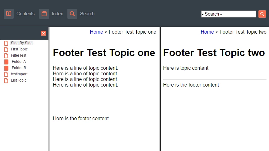

Personally, I'm a bit confused by what you are asking. By default, a footer is placed at the end of a topic. So as you mentioned yourself, it might appear as shown below:
And as you can see, it's not consistent and follows the end of the text on the page.
Now you might notice that the page on the left has a bit of a larger gap that appears after the text and before the footer. And that's because there are Paragraph Marks that were added after the topic content.
As for attaching a footer to all topics, it's really quite simple. Just display the Topic List pod, select all the topics via Ctrl+A and choose the desired Master Page to associate with the selected topics. Poof! All topics should now sport a footer.

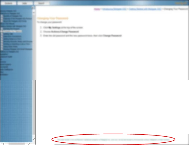

FWIW, I was able to achieve the fixed footer via custom css within RH, but the results aren't ideal. Here are some pics (that I probably should have included in the original post):
Short topic - footer shows at bottom:
Here’s a longer topic on first opening. Notice the footer is visible, overlapping content, even though there’s more to the topic:
And then when you scroll down to the end of the topic:
I've given both options to the client to have them decide if they want a floating or fixed footer. I was just fishing for any alternatives I may have missed.
