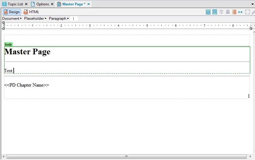

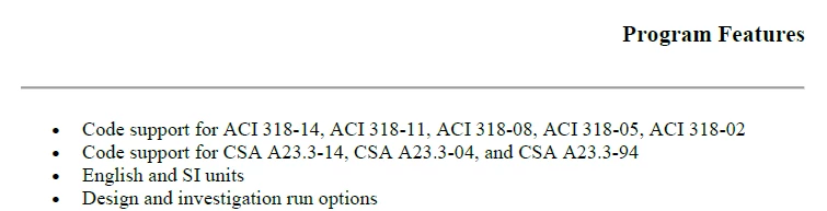

I'm having issues with formatting in RoboHelp. When I am in RoboHelp I will have the format to show the Topic title to the left of the page, which is how I like it. However, when I create a printed document (PDF), the formatting of the topic title goes to the right of the page, which is what I don't want. I have already created a MaterPage on RoboHelp formatting the topic title to the way I want. I have also created a stylesheet that displays "Heading 1" to the left of the page and have changed my topic titles to "Heading 1." Still when I output to the PDF or Word, the formatting to the topic title is wrong.
How should I go about this?
Thanks.
RoboHelp Masterpage
PDF topic example ( "Program Features" should be formatted to the left)

Hi Arianna,
Maybe you can try the print output with RoboHelp's sample projects (Employee Care2) (By using it, I generated the print output, and the chapter name came indented to left). You may try comparing your masterpage with the sample projects masterpage, i hope you would find a workaround.

I think you might do well to take it in phases. PDF is always created from Microsoft Word. So first step would be to generate a Word document. After generating the Word document, does the same thing occur? If so, you know it's some setting in RoboHelp or that process causing it.
If the Word document looks fine, then you need to examine the settings in the PDF creation part.

Hi Rick,
Thanks for the reply. The same issue is happening when I output to Word. What settings in RoboHelp would I need to change?
