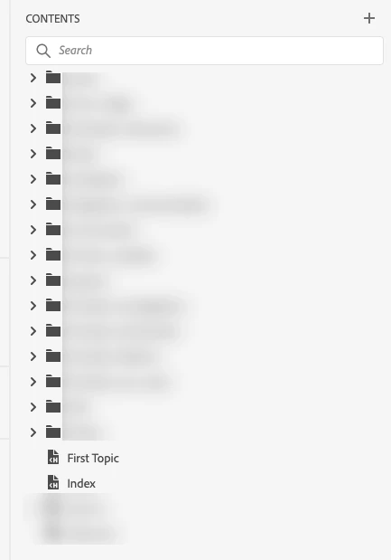

    So what you can do is create index.htm file at the root level of the Contents section (under the Author tab).  That will make the url for the page in blah.com/index.htm - the same link as frameless minus the child topic appended to the URL.

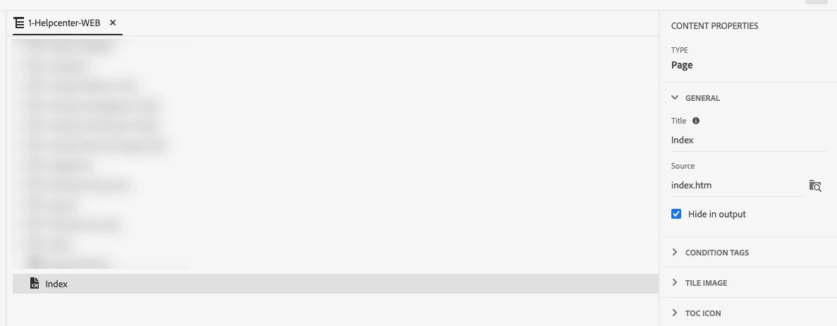

    Next, you would add the index topic to your web TOC.  After doing so, click on the index entry in the toc, and check the hide in output checkbox.  This will make it so that the index topic is included in the build but not listed in the TOC.
