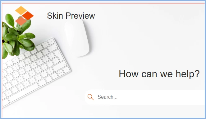

    If the first image I posted has any sizing removed, it shows like this.
    Try playing around with getting an image that is acceptable with no size settings.

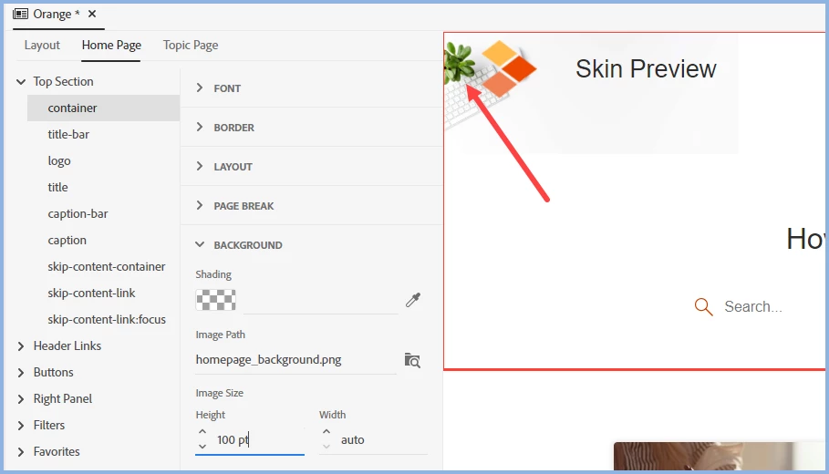

    Jun 17, 2021 4:57 PM UTC
    The sized image (100 pt) shows more than the auto image.
    You mean you can see more of the greenery but at a smaller size rather than you are seeing a larger image, correct?
    These things are very much trial and error and I don't know the size of Adobe's default image.
    I just created an image 1275x375 and it filled the whole container set to auto. See the Contact page on my site and email me your image.

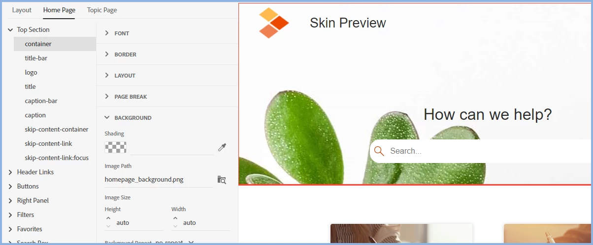

    Jun 17, 2021 4:07 PM UTC
    This is the image set to auto
    Here is the image set to 100pt
    Still some confusion over what you are trying to resize. Perhaps a screenshot would help.

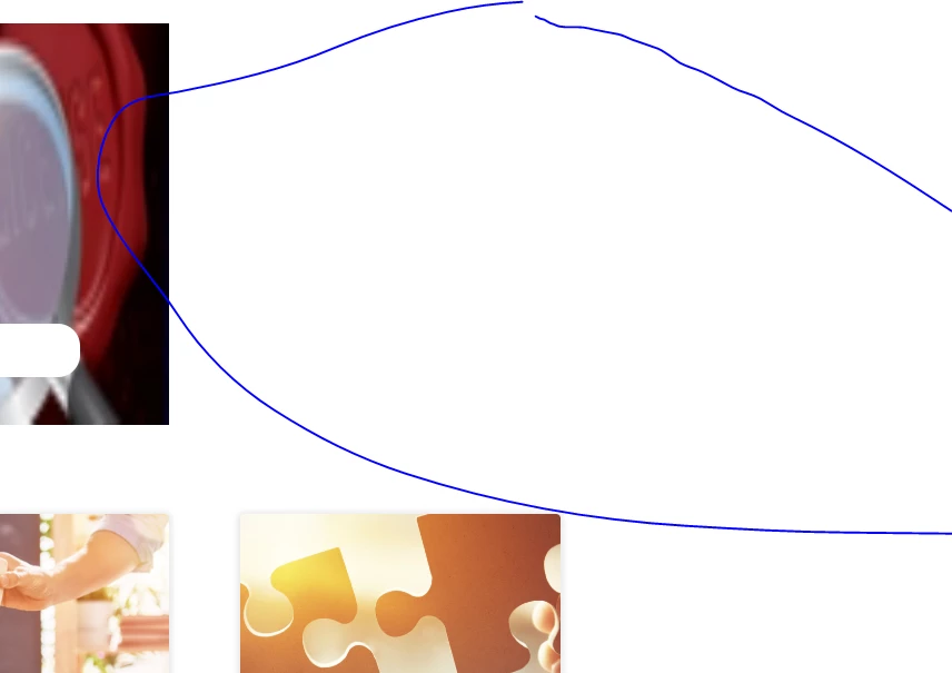

    Okay, so your two images will help in this case. The sized image (100 pt) shows more than the auto image. Meaning the image is cropped to fit. But if I would want 100% of the image to show, in the auto formate, what size should the image be?
    In the end, what I am trying to do if possible, determine the dimensions for 100% (outside of robohelp) of the image to show, but it will be resized automically based on screen size.
    I resized an image (1275x375px) that shows 100% of the image on my laptop screen, but then the image is chopped (1275 is not long enough) when I go to a larger screen. See below where larger screen has large blank area:

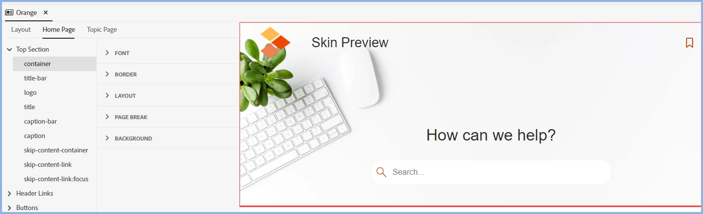

    I thought you wanted to resize the three diamond logo next to Skin Preview. That is controlled by the logo setting. When you double click the skin it opens the preview. When you click something in the settings it is highlighted with a red border.
    ________________________________________________________

    Correct, Container>Background>Image Path that is what I am trying to customize.
