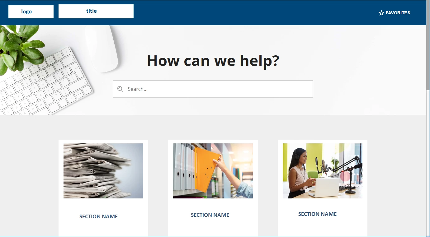

  1. Select "Use skin home page" on the Layout tab. This gives you a series of tiles for the top-level heads, plus a prominent search box, background photo, etc. See the attached Studio_skin_home_page.png file for an example (I had to make it super-generic so I don't reveal too much 🙂 ).

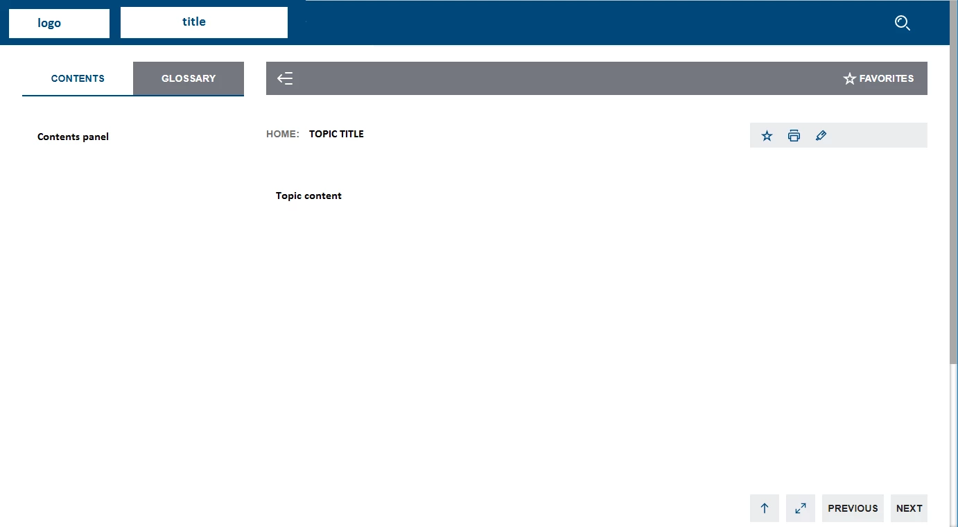

  2. Deselect "Use skin home page". In this case, the help will open on the first topic in your table of contents. This option gives you the usual structure of a topic page with the left and right panels, and the search icon in the header. See the attached topic_page.png file for an example (again very generic).
The project I'm working on has about 25 top-level heads, which is a lot of tiles to show on the home page. Is it possible to design and create a new home page that does show any tiles but still preserves some of the other elements, like the background photo and search box? And could we replace the tiles with elements of our choosing, like maybe some small graphics, short text descriptions, hyperlinks to popular topics, etc. (details TBD). I realize we could design a new topic that incorporates these elements, but then we will get the topic page layout; i.e., it wouldn't be a true home page, just another topic.
I don't see a way to do this, but if anyone has any ideas, I'd love to hear them. Thank you!
    AmebrCorrect answer
    Jul 1, 2022 2:12 AM UTC
    When you are using the home page, you can also specify another topic which will be placed below the tiles section. This topic could hold your links etc.
    For the tiles themselves, you could try setting the TOC Tiles container Display setting to 'none', and see if that works for you. I haven't tried it myself, so am not sure what the implications might be.
    Jul 1, 2022 2:37 PM UTC
    @Amebr Your suggestions seem to work! I was able to prevent the tiles from showing by setting display to none for the TOC Tiles container in the skin. Then I created a simple topic with some hyperlinks and specified that as the Home Page on the Layout tab of the Frameless preset. In the output, the Home Page topic content was displayed right below the photo and search box (in other words, there was no empty space where the tiles used to be). Fortunately I will be able to work with a designer to come up with the home page we want, but it looks like this could be a solution for us.
