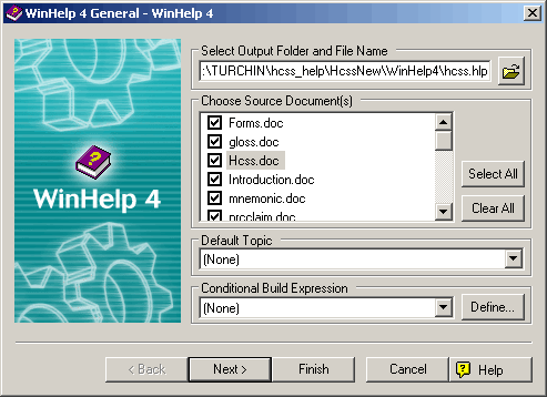

    I'm outputing to WinHelp4.  Another thing I did was instead of generating the primary I did a view of the primary layout and I got a message stating "WinHelp4 output is out of date".

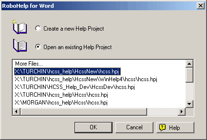

    WinHelp 4 is set at the primary layout - "Generate Primary Layour (WinHelp 4).
    Here is a screen shot of my file structure where the help file is being generated to:
    Could there be confusion between the first two projects in the first image?
    Try deleting the GID file and opening the help again. I forget what controls but it may be relevant.
