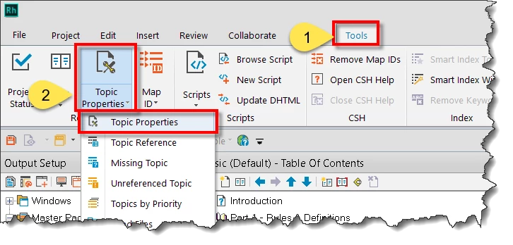

One possible way would be to use the Reports. In RoboHelp 2015 Release, click the Tools tab and then the Topic Properties.

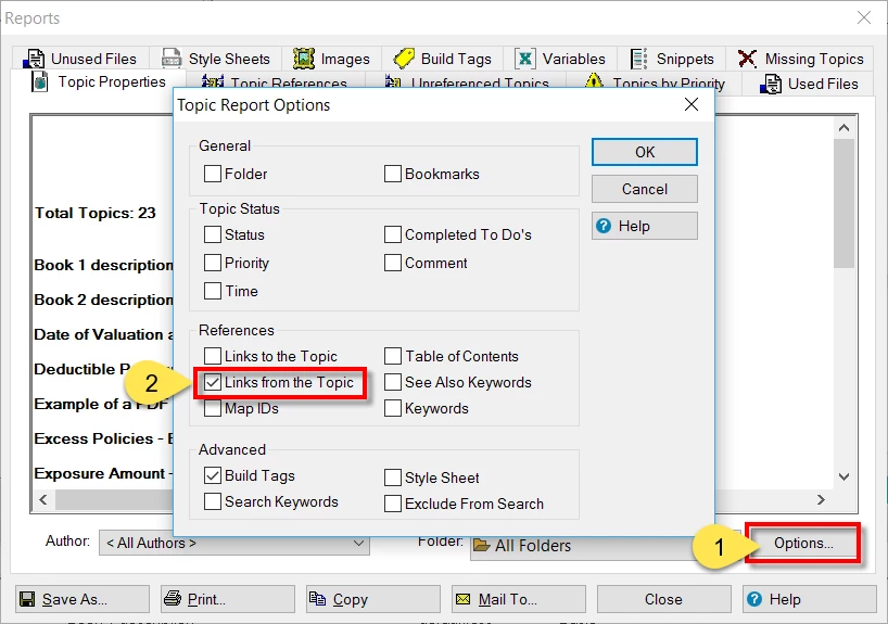

Then you will want to click the Options button and ensure that only the option for links from the topic is enabled.
This should get you links from Topics. Keep in mind that there could be other links too. Links from the TOC, the Index, Headers and/or Footers, External Content Search, etc.
