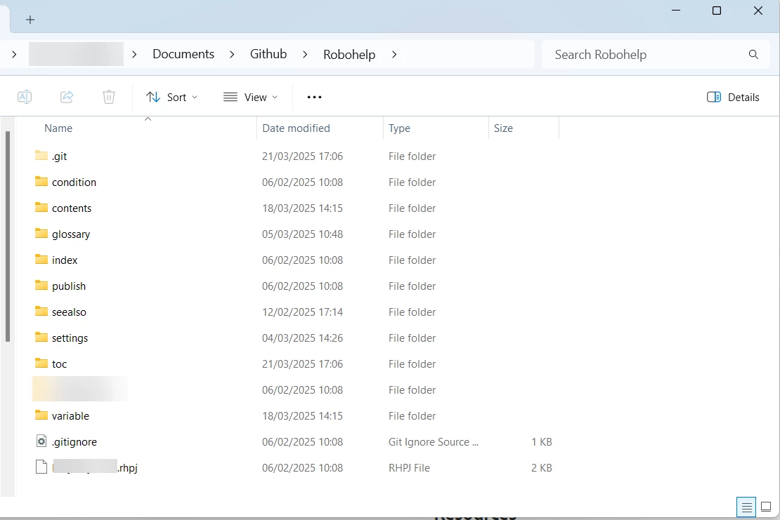

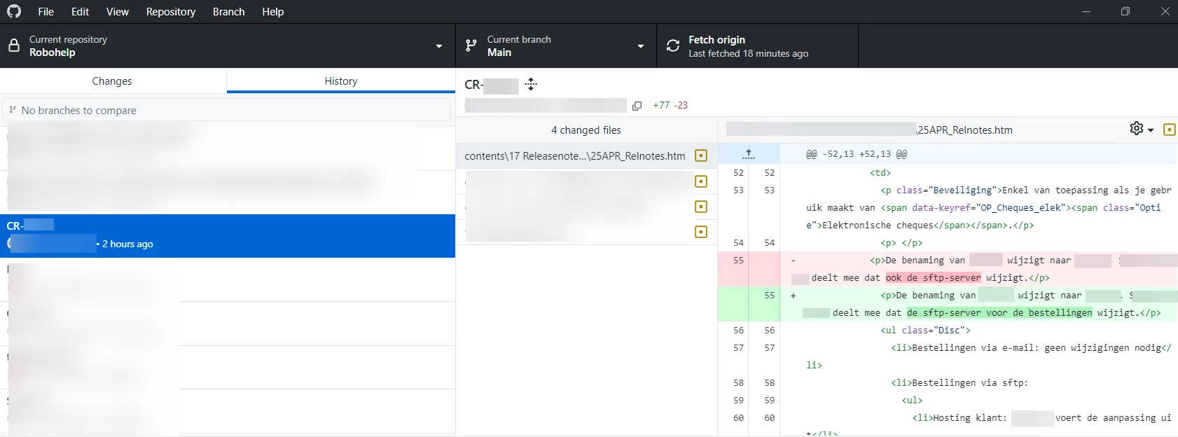

    Do not use the Robohelp Git plug-in, that works about as well as the Robohelp translation feature.
    I don't see any real issue with simply using Github desktop and Robohelp. You just create a git repo in the folder where the Robohelp project is present (in Github Desktop, Add existing repository ... > select the folder containing the RH project).
    Fundamentally, when you write stuff in RH, all you do is change some HTML of a topic.
