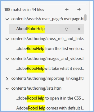

Peter Grainge
Jun 29, 2021 7:55 AM UTC
I get a response like this. If I double click one of the highlighted results it opens the topic with the word highlighted. The refresh icon to the right shows has a tooltip Replace This Result.
Instead you are getting an application error so as Amber has suggested, try another project.

Jun 29, 2021 12:05 AM UTC
I can't reproduce the error you're getting. For me, double-clicking on the file name does nothing, but double-clicking on one of the matches within the file opens the topic.
Can you reproduce the error using one of the sample projects (should be in your Documents > My Robohelp Projects folder)? This should indicate if it's some problem with your project, or an installation problem.
