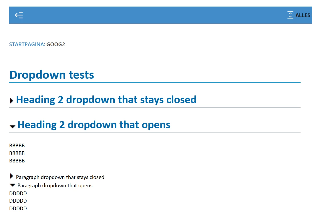

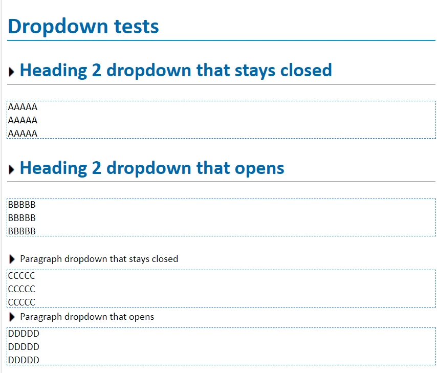

For some reason, a few writers want the dropdowns to auto-expand upon loading the page.

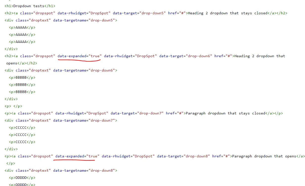

I can achieve this for an individual dropdown with the attribute data-expanded="true".
Before I loop through all dropdowns in my project, I'd like to ask if I'm not overcomplicating things and if there is a simpler way of doing this?
