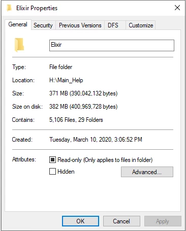

    Joe@MajiqAuthor
    Aug 14, 2020 4:34 PM UTC
    1. Is the project local?
      • Yes. I was running it a network drive, but I copied it to my C: drive to do the upgrade.
    2. Define huge. You may be right but so many times I have heard that and back comes the answer that is has a thousand topics, not huge. Number of topics and number of images is more useful.
      • Ok, so not huge by your standards.  About 700 topics. I don't know how many images there are (I recently took over the project), but I would say it's very "image lite." The whole directory is about 380 MB (screenshot below).
    3. Are a lot of the topics and images in the root of the project or are they mostly in folders?
      • All the topics, images, PDFs, and video files are in the same directory as the project file. The only folders in the project are in the screenshot below.
    Thanks for your help!
