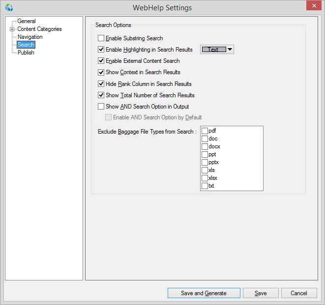

Hi! I thought I'd share a screen print of my Search options, in case I have any odd selections. If you have any additional input or feedback, I'd really appreciate it! My client is chomping at the bit to get the help distributed.
Captiv8r
May 26, 2015 3:46 PM UTC
Hi there
I know several years back in another lifetime, I found myself having to reinstall something called the "XML Parser". And I believe I recently saw a thread here in the forums where this was also the fix for a broken search.
So perhaps head over to How to install Microsoft XML Parser and Microsoft XML Core Services (MSXML) and follow the steps there. Then re-generate your help and see if search begins working again.
Cheers... Rick

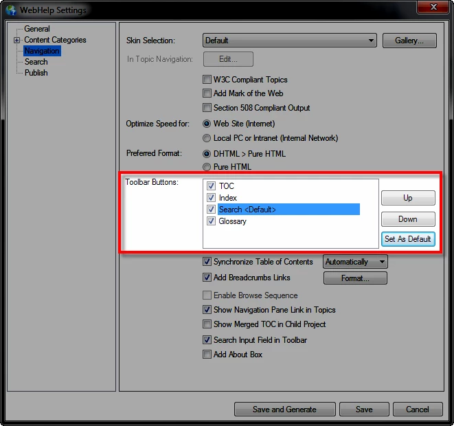

From RoboHelp, look at the properties for your Single Source Layout recipe. Once the properties are open, click the Navigation section on the left and look at the options on the right. They likely resemble the image below:
If so, click to select the TOC, then click the Set As Default button. Generate again and you should be set!
Cheers... Rick
