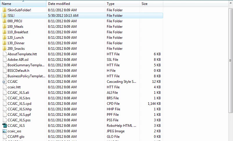

thanks for yur response. I've attached a picture of the extracted files. there is no xpj file anywhere.the ccaic_xls file shows a file type at Robohelp HTML.
I am so confused and stressed. anys assistance in finding the hpj file is appreciated. thanks a million

My own guess here is that the ccaic_xls is the XPJ as it bears the RoboHelp icon. Windows is likely hiding the file extension from you as it should be associated with RoboHelp. What happens if you just double-click the ccaic_xls file in the list? That should cause RoboHelp to open.
(assuming, of course, that you are looking at all the files after extracting them to a folder)
