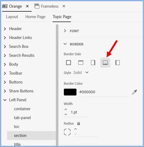

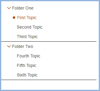

    You can get close by applying a bottom border to the section.
    That will give this line. I can't see a way to get a partial line. Changing the width to 0.5 and/or changing the colour might help.
    ________________________________________________________

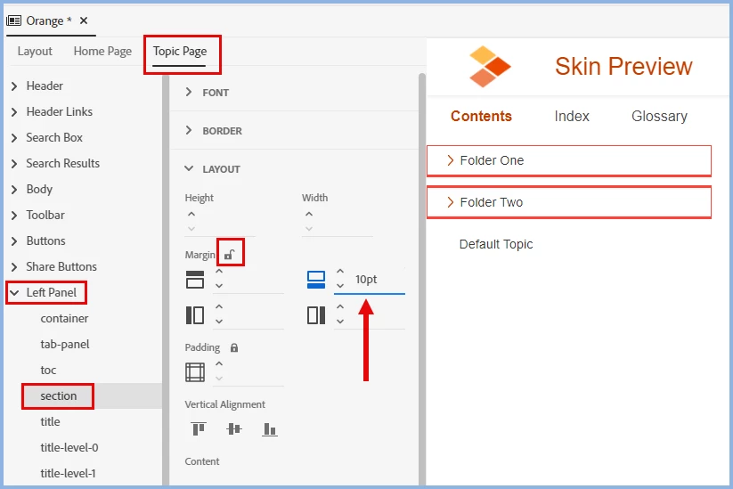

    You haven't said which skin you are using but I think the others will be the same. Click the padlock to apply a margin below the sections.
