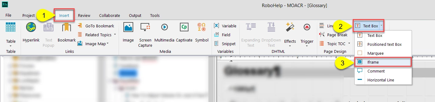

Hi there
I believe what you are looking for is known as an "Inline Frame". Put your mouse where you want the information to appear, then from your ribbon, click the Insert tab, the little arrow area to the right of Text Box, then choose Iframe.

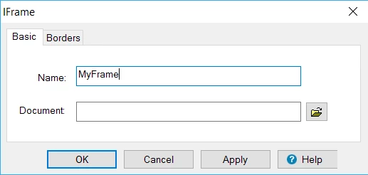

You should then see the dialog allowing you to name the frame and choose the document (or HTML page in your case) to be presented in the frame.
Once you get it configured, you then just click the OK button and it will be placed inside your topic. You click and drag the corner to size it inside the topic. Or, if you want it inside a DHTML Drop-Down, you select the frame and cut it from the topic page, then insert it into that little drop down editor window.
