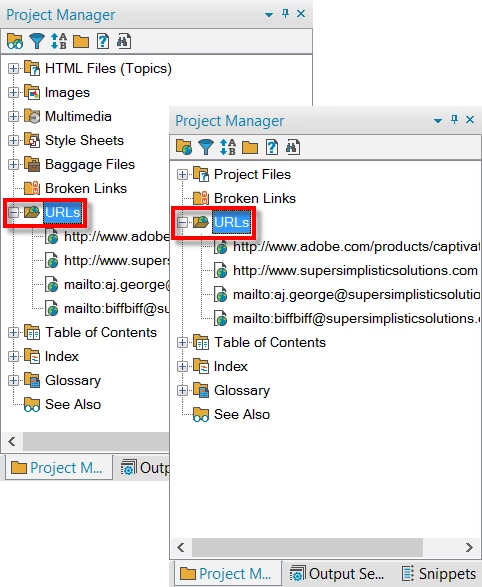

Hi there
When you look at your Project Manager pod, you should see a "folder" that is named "URLs".
Your URL should appear in this location. And you should be able to right-click it to see options.
Have you tried that?
Cheers... Rick
