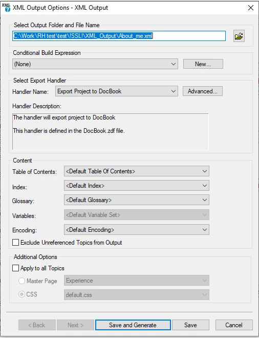

    Try changing Handler Name to the xhtml option

    AmebrCommunity ExpertCorrect answer
    Nov 1, 2021 3:05 AM UTC
    Nov 3, 2021 1:11 AM UTC
    Tks, solved.

    Did you select Export to XHTML in the output options dialog box? I just opened it and it defaults to DocBook.
    Nov 1, 2021 2:25 AM UTC
    Yes Amber. Please see the pic above.

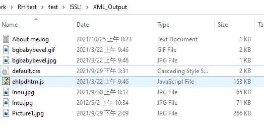

    There's an  XML Output you could try. Create a new output in your Outputs (SSL) pod and select XML Output, and see if that works for you.
    I don't believe there's any built in method for generating dita content.
    Oct 26, 2021 7:48 AM UTC
    Hi Amebr, I used XML Output, but I don't see an xml file, seems not working.
