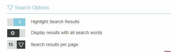

Assuming that you are using RoboHelp 2015: In layouts of Responsive HTML5, by default search is OR. When you start typing search term it shows the option for AND(All search terms).
Also number of search results are more in case of OR not AND.

In Output, On Search page there is option to enable And Search Page.
As you said  you want same results for "Repository files" and "Repository and files", It will be same only when in first case, AND search is enabled.
When in a phrase there is "and", it means AND in boolean terms and does AND search.
In UI, there is not an option to enable AND search but you can make changes in the Topic.slp file and make it work your way.
