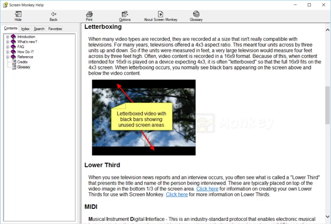

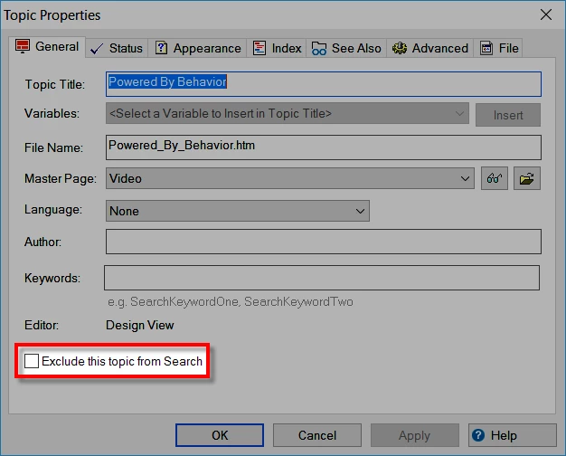

Hi there
One way you could achieve this would be to ignore the built in RoboHelp glossary function. Then create a normal topic that contains Glossary Terms and Definitions and link to that topic as needed.
Benefits are:
From the Topic Properties you are able to tell RoboHelp to exclude this topic when searching.
In a topic that functions as a Glossary, you would also have the ability to include supporting images as well as hyperlinks.
Cheers... Rick
Thanks – that’s a possibility both for restricting search and  the whole images ability (very attractive). Still… shoot. Was hoping to make use of built-in functions. Good food for thought though – awesome!
