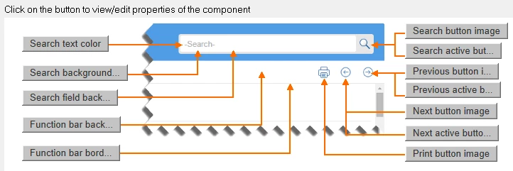

Sorry if this is a duplicate question and I am just not seeing the obvious.  I looked at post "How can I toggle view of drop-down texts in a topic for Responsive HTML5?"  I see that it appears to address how to add RoboHelp's built-in functionality for expanding all/collapsing all drop-down texts using the Azure Blue layout in RoboHelp 2019.  In that post, one person (Amebr) mentioned thinking the buttons appear below the search bar in the Azure Blue skin.  I looked at the Azure Blue layout, and I see options for the Printer and browse buttons below the Search box, but I don't see options for adding expand all/collapse all buttons.
Is this functionality available in RoboHelp 2019 (Classic) for the Responsive HTML5 output?  If yes, where?  Am I missing it because I am looking at the screen layout and not the skin?  My Output Setup tab lists "Azure_Blue" under "Screen Layouts" but not under "Skins". Do I need to add "Azure_Blue" under "Skins"?  If yes, how? I see the option to import a skin, but I don't see an Azure Blue skin to import.

  4. Expand All/Collapse All is not present in RH Classic Responsive HTML5 layouts out-of-the-box. It is added to RH 2019 HTML5 Skins. You can try it out in RH 2019.
