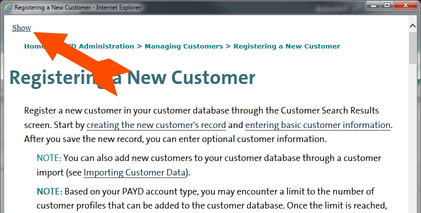

Hello, I'm wondering if you can help me. We are using Robohelp 2015 to author HTML webhelp and context-sensitive help for one of our applications. The webhelp and CS help content was originally authored in Robohelp 8, and we have since upgraded to RH2015. My issue is with the 'Show' link in the top left corner of the CS help windows. Its purpose is to display the TOC, index and search functionality. Feedback from our users indicated that this wasn't evident by the word 'Show', so in RH8 I was able to change the text to something less cryptic.
However, now in RH2015 I can't figure out where to edit that text. Since it was several years ago that I changed it, I can't remember where the control is either. I'm hoping someone on here knows where I can change the text.

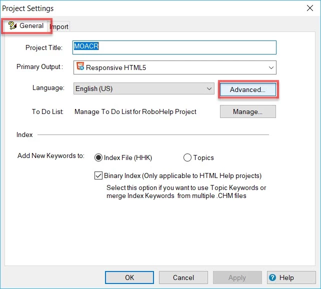

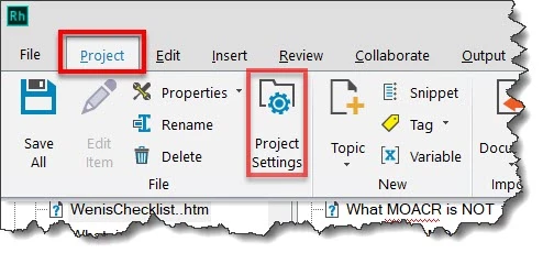

You should be able to change it by clicking the Project tab and Project Settings.
From there, click the General tab and the Advanced button.

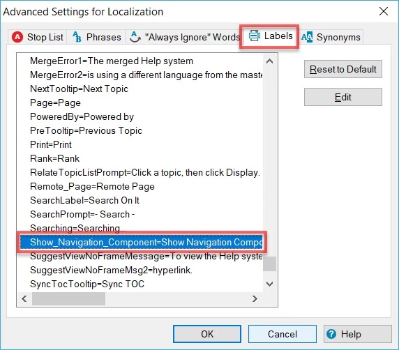

Lastly, click the Labels tab and scroll the list of terms to the WebHelp section and find the Show bit. Change the text to the right of the equals sign.
Generate the output again and see if it was changed! It should be. But if not, you may need to re-visit the steps and find a slightly different place to adjust it. It will surely be in this dialog.

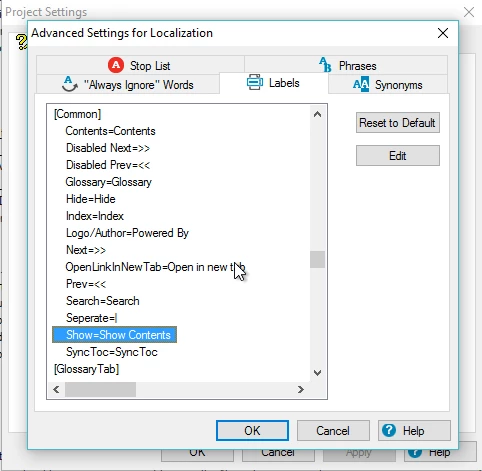

Rick's method is correct, but instead of using the property he highlighted, scroll through the list till you see the "Common" group of elements.
Select "Show" and then click "Edit" and change "Show" to "Show Contents" (or whatever you want to use).
I used this method and got predictable results.

Project ribbon > Project Settings > General Tab > Advanced button > Labels. Scroll down and change as before.
