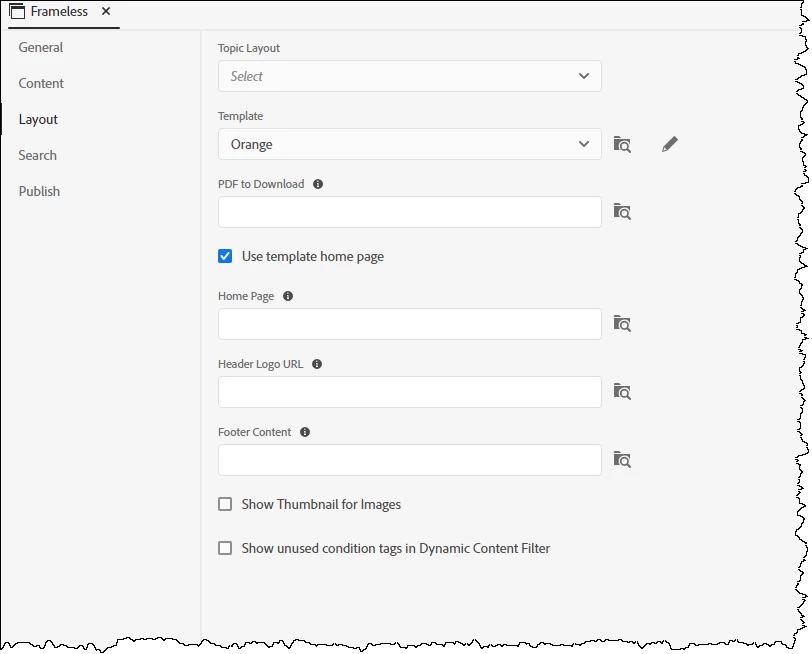

    First of all you will only see any tiles if you select the Use Template Home Page option.
    That will open the home page showing all the tiles for the top level sections in the TOC.

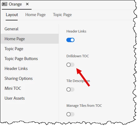

    With Drilldown TOC deselected, the next thing will be the normal TOC on the left. So minimising the number of top level sections will achieve what you want there.
    If you select drilldown, then you will see the next level of sections plus any topics at that level.
