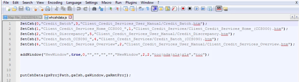

Thanks for your suggestion. I used a dummy project to test your directions and was able to get a satisfactory result. I want to share something I noticed, though, as it may help someone else.

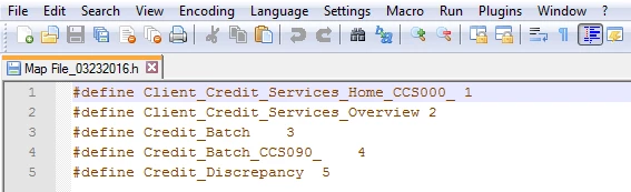

First, to test your directions, I created a new .h file called “Map Files_03222016” and copy/pasted contents from an old .h file into the new one using Notepad ++.

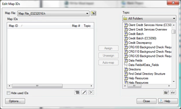

After I completed the rest of your instructions, I opened the new .h file in the RoboHelp interface, but, I could not see any of the contents I had added.
At first I was concerned that my contents somehow did not get copied into the .h file. However, I checked the .h file in Notepad again and confirmed that the content I added was in indeed there. (Also, I remembered that I think I saw other threads on the community board regarding Map IDs that appear to be “missing/invisible” in the UI but are actually in the project, so I will do more reading on that later on).
Then, I generated my project so I could check the whcshdata.js file, which is the file I give to my developers so they can connect the content from the help system to our application.  Everything I expected to see was indeed there.
