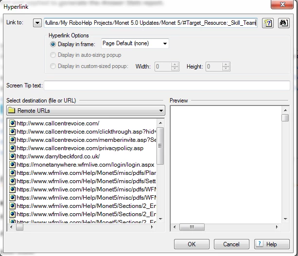

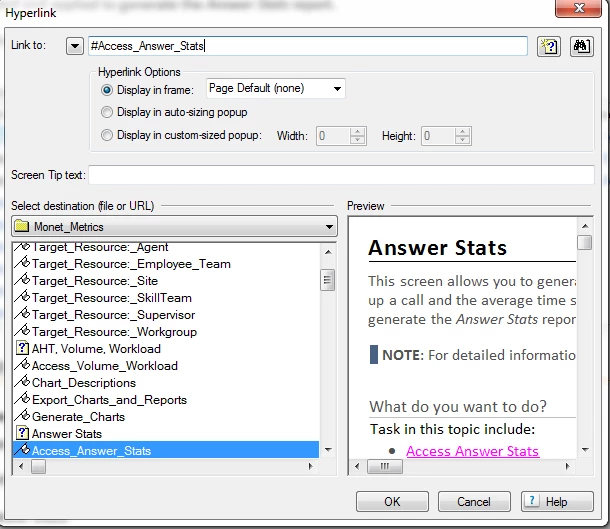

Hi Captiv8r: Here are two screen shots of the failed links. When the project is Generated, some of the links change to the Remote URLs. The image on the right is how I create the links to the bookmarks in the topic page. The Topic Preview of the page has fully functioning links. It does not happen with each link, but enough to keep my project from being deployed.
The only other thing that I observe about the failed links is that there is a colon in the heading it is linked to. For example, Target Resource: Site. I went ahead and tested links after generating and after publishing, and all links worked. I hesitate to upload again to the Web server, as the facility is in Europe, and I want to ensure I have a solution before exercising them again.
