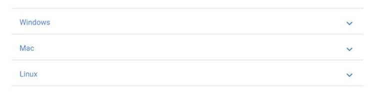

Spoke too soon. The Indigo Layout puts the navigation pane on the right, which is perfect, but the Search results are on the right nav pane as well - there is no option in the layout setup to switch the results to display in the main window (as there is in the Azure Blue layout). So the layout addresses one requirement, but takes another away.
They also hate Twisties, and want drop-downs to look like this:
Captiv8r
Feb 20, 2017 8:54 PM UTC
Hi there
Wondering if the answer isn't as simple as just using the Azure Blue layout you mentioned but just turning off the TOC. Once you have turned off the TOC, you create a main page that behaves as you want. Then configure that as the default topic.
Cheers... Rick
