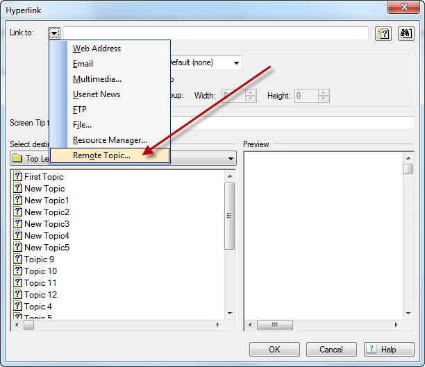

Hi Helene and welcome to the forum.
Your problem sounds like you have your project's default Single Source Layout set to something other than Microsoft HTML Help. Go to your Single Source Layout pod, right click on the Microsoft HTML Help layout and select the Set as Primary Layout option. The next time you link, you'll see a Remote Topic option (see below). This allows you to select the CHM and select the topic from it.

I just checked, and the default in Single Source Layout is Microsoft HTML, so that's ok.
BUT I tried to do as shown at your screendump - AND that really made a big different.Thanks a lot, I've been struggeling with this issue for almost a week !!
