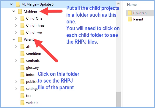

    Peter Grainge
    Mar 28, 2022 3:51 PM UTC
    You create the topics, images and so on in the respective projects. At this stage think of each project as self contained.
    The fact it goes wrong when you generate screams at the issue being you have still not got the structure right.
    In File Explorer when you click on the parent on the left side, you should see the rhpj file and the various folders for that project. When you click on Child Projects, you should see folders for the child projects.
    1. Create a folder such as MyMerge.
    2. Copy the Parent project directly into it so that when you click on that folder you see its RHPJ file.
    3. Create a folder for the child projects and copy the folder for each project into it. You will only see the RHPJ file when you click on your equivalent of Child_One etc.
    If you still cannot create the cross project links, can you share the projects? If you can, then see the Contact page on my site and send the project as instructed there. Do make sure you include a link to this thread and please do not email the projects direct.
    What I need you to send is a zip of the MyMerge folder equivalent so that I can see your structure.

    Peter Grainge
    Mar 22, 2022 12:46 PM UTC
    No the skin does not matter. The fact that the links in the demo work strongly suggests one the two things I have suspected.
    1. Your source projects are not structured the same way as the demo. It is important that the parent is in one folder and all the child projects are in another folder. The parent is off the root so that when you click on the folder, you see the rhpj file. The children are then in a second folder off the root called children or whatever you want. The key bit is to get to the rhpj file, you have to go one level deeper.
    2. You are not creating the links as I describe.
    I'm pretty sure it is (1). Using that structure the relative paths are correct and work, any other structure they will not work unless you manually edit them. Look at the links in the demo and yours. They will likely be different.

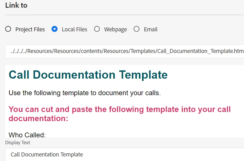

    Peter Grainge
    Mar 9, 2022 4:50 PM UTC
    That sounds like you have created the link using the wrong option in the dialog. Did you use project files or local files as shown?
    The link will work in preview either way as at that point the URL is correct. However, it is not when you generate.
    Download the sample project and upgrade it. You will see there.

    Mar 9, 2022 4:56 PM UTC
    I used local files:
