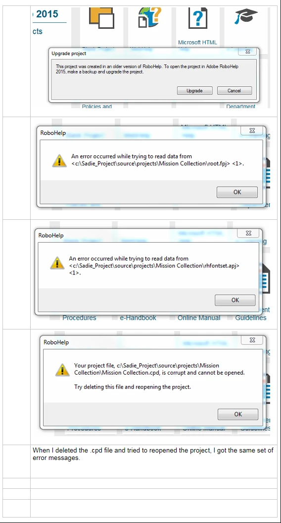

I am having a problem with some of my child files opening in Robohelp 2015 from Robohelp 10. Publishinng to WebHelp. Using a local drive. May I get some assistance in recovering my project? This is the dialog I get when trying to open it.

Do you have any source control in play here? If so, you probably need to remove the project from it first, upgrade it & then check it back in.

Jeff,
Thank you for assisting. Please define 'source control'
Mike
Jeff_Coatsworth
Feb 23, 2016 8:47 PM UTC
Robosource, GIT, SharePoint, SVN, etc. etc. – any sort of repository system where multiple authors check-in/out project topics
