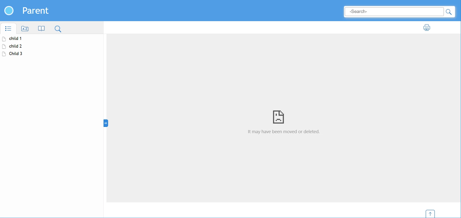

5月 16, 2019 11:19 午前 UTC
Hi Peter,
When I use your method, the child projects are being displayed correctly however the parent redirect does not work, it shows the following:
