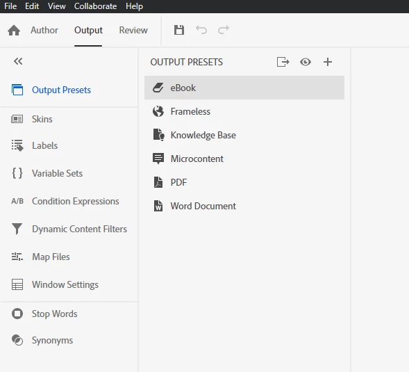

    RoboHelp is not designed to work within Visual Studio, it is designed to be generated and published to a web server. There may be some way your predecessor found so we need to find out more.
    Find out what IT do with the output when they deploy it. I am hoping it is something like they simply move the files to the webserver. If that's the case we then need to figure out what was being generated.
    We might be able to do that if you go to Output > Outputs and seeing what preset are there. Add a screenshot of the options. Please use the photo icon to insert images within the post. Seeing an image inline with the text makes it easier for anyone answering or viewing the post.
    In each one look to see if there is an output path. Which ones have a path defined.

    Our IT does just move the files to the webserver. My predecessor did the updates in RH 2019, and now we are using RH 2020. I had to create a project from scratch, so in the "author" section, I currently only have the new pages I want added, as well as pages I've downloaded to edit. Another question I had (getting ahead of myself most likely) is that once I figure out how to generate the correct output, will this project overwrite what we currently have deployed? For instance, since I only have like 10-12 pages in my project, when this is deployed, will it just show these 10-12 pages in our new 'Help'? Or will it retain what's already there with the addition of these?
    There are currently some pre-populated presets (attached).
    Jun 15, 2023 4:02 PM UTC
    And to specify, none of the pre-populated outputs have defined paths. They're all blank (probably because I haven't used them and this is a 'new' project I started).
