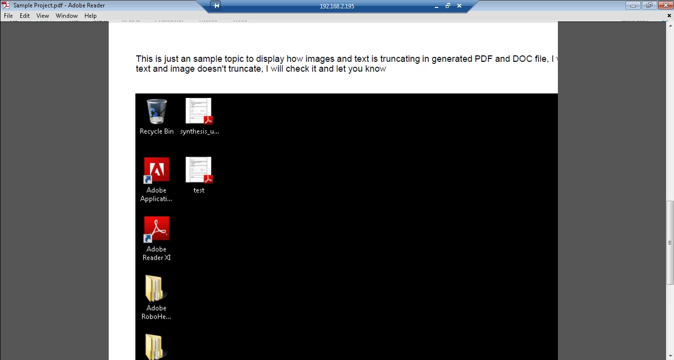

    HI All
    Thanks for your input, I have created a demo project but still struggling to send , I am posting the images , Please see, If that helps in understanding the question
    Below is the Sample Project, I have created in Robo Help 2015
    From above Project, when I generated PDF File, Image and text is Truncating as seen in below images, Same is happening in Word File

    The reason is quite simple and I'm sorry I didn't pick up on it sooner.
    For printed documents (Word or PDF) you must limit your image size to the width of a piece of paper as the image will not be scaled down. Scalle them to about 7.5 inches to allow for margins and try again.
    There are two ways in RoboHelp.
    1. Double click the image and click Size. That may work OK for tweaking but for this degree of scaling, Option 2 is better.
    2. Click Pods > Tool Box and look for the resizing tool. That gives much better results.
    SnagIt is a third party tool and considered the best by many. That enables you scale and also remove blank space from an image both vertically and horizontally. That way you avoid resizing text and other parts of an image, you just lose the blank space.
