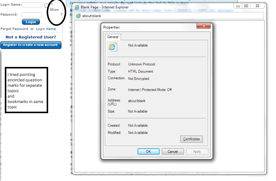

I am using trail version of robohelp2015, I have few issues when i open webhelp popups from the links in webpage in IE. It works fine in Chrome.
I click on help in on page, which opens a webhelp popup window. i don't close the popup and go to next page in my test website on now again click on help. Now it refreshes the webhelp popup with blank window in IE11.
Help would be appreciated.
The page is entirely blank without skin

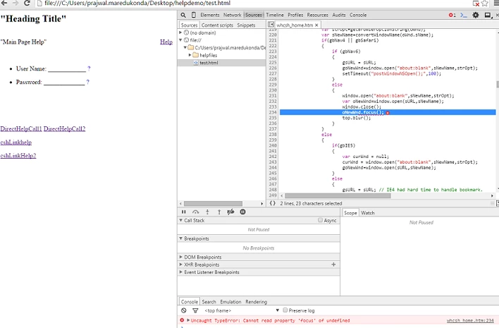

Small Update to question: when i checked the debugger Console in IE11 shows access denied error in whcsh_home.htm line 295
{ function postWindowNSOpen() : goNewWnd.document.location.href=gsURL; } //error
and for focus issue in chrome the developer tools shows Uncaught type error in  whcsh_home.htm line 234
{if(gbNav4 || gbSafari) : < oNewWnd.focus(); >} //chrome error
