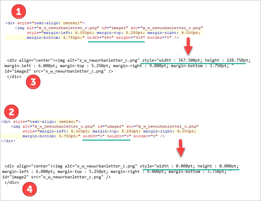

I'm using TechComm 2015, importing Frame docs into RoboHelp for Responsive HTML5 output. Specifically with regard to image conversion, when I set the "preferred dimensions" width and height to 0 (to prevent image sizing during conversion), the images do not appear in the output.
Disabling above does allow them to appear in output, thus I don't know why this is happening.
Wondering anyone has comments that will alleviate?
Thanks!

    Since I don't have a ton of images in my FM to RH project, I can't tell you definitively that this was or wasn't working, but I did find this TCS Blog post that talks about setting the zero size thing - https://blogs.adobe.com/techcomm/2009/10/preparing_anchored_frame_for_conversion_in_robohelp.html.
    This would imply that it worked (at some point), but may have gotten busted later. What is coming through to your RH topic with regard to the <img> tag they mention?

    I've inserted details below that outline the situation, as per your comment re <img> tag:
    • 1 = HTML after importing from FM with default image conversion settings, i.e. no height and width specified.
    • 2 = HTML after importing from FM where the image conversion settings for height and width are both set to 0 (zero).
    • 3 and 4 = HTML from responsive output from each of the respective imports.
    • 3 Output does display images, however, not very well (too small... not clear), which is why I was exploring the option of using zeros for sizing width and height as per the blog you reference.
    • 4 Output does not display images.
    In general, the code seems to be fairly predictable in terms of the conversion settings, i.e. nothing seems to be far off. Caveat… I’m not a real coder 🙂 .
    Any comments appreciated!
