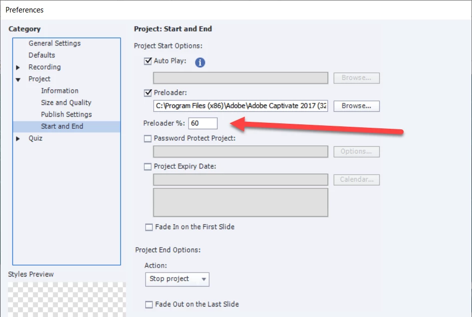

    I think the buffering you are referring to in the Responsive HTML5 Layout Editor is a designation for a "Loading" image of the TOC and Topic content, but I'm not sure if it calculates for an unusually long Captivate simulation which is a separate object. For the Captivate side of things, you might take a look at the dialog below for setting a Preloader buffering property which looks like this:
    For slow bandwidth situations, you can intentionally preload long videos so that the end-user will start viewing when a certain percentage is downloaded so the viewer can avoid jerky delivery. Unless you have a fancy designated "streaming server" to deliver video, the download is going to vary according to the end user's connectivity.

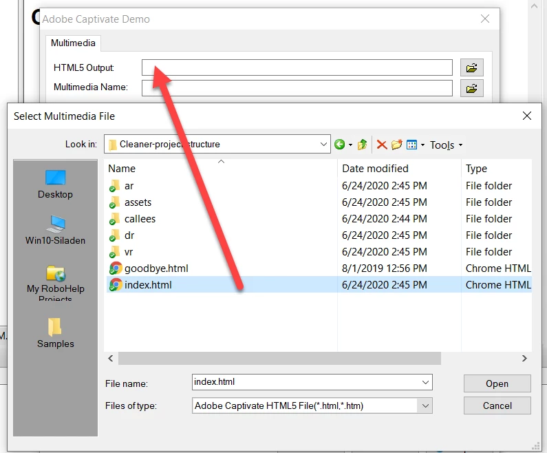

    1. I'll assume you have  published your Captivate project using the HTML5 output.
    2. If you are using Rh Classic, then you would want to use the dialog below to add your HTML5 Captivate demo. With Classic, you sort of have one foot in the old (SWF) and one foot in the new (HTML5). Let me sort this out:
    3. You would leave the Multimedia Name field blank because there is no longer a SWF involved.
    As you can see, there are quite a few folders and files which support the Captivate demo.
    4. Conveniently, these are all "zipped up" into a single file with the extension ".cpz" which is then added to your Baggage folder.

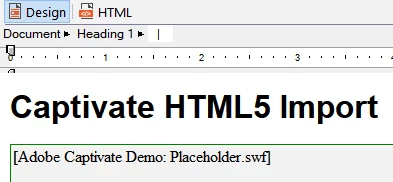

    5. In the Design Editor panel, you'll see a placeholder .swf. Don't let that throw you. The old Classic version used this as a transition to the new HTML5 technology which is more streamlined.
