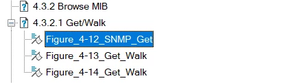

    I can't find out where to change the content heading levels.
    The above snap shot has the ilstration.
    Lily

    Hi, Peter,
    Just last issue to fix: why content has only till heading 3, while topics has heading 4?
    Somewhere the setup wasn't done right.
    Please advise.
    Lily
