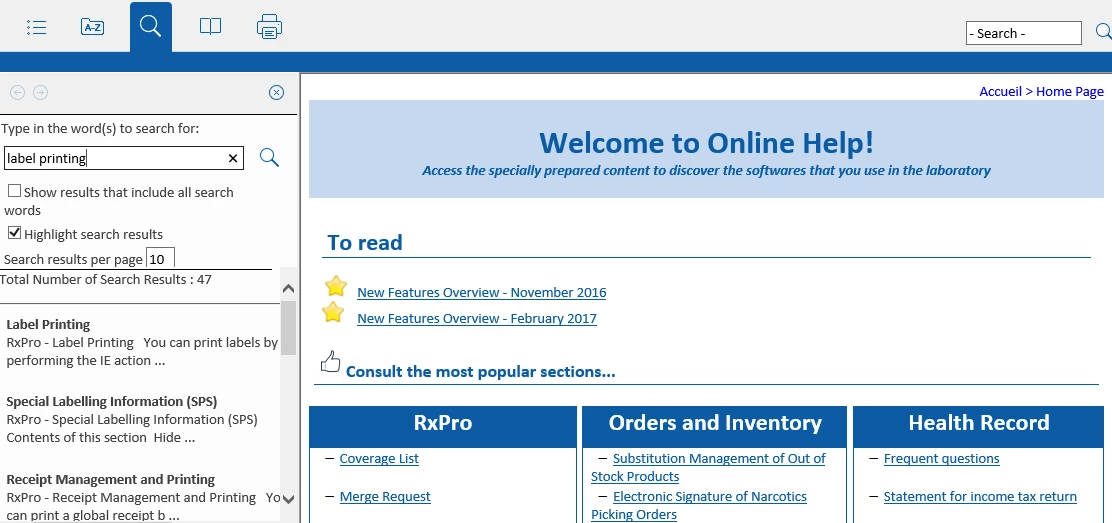

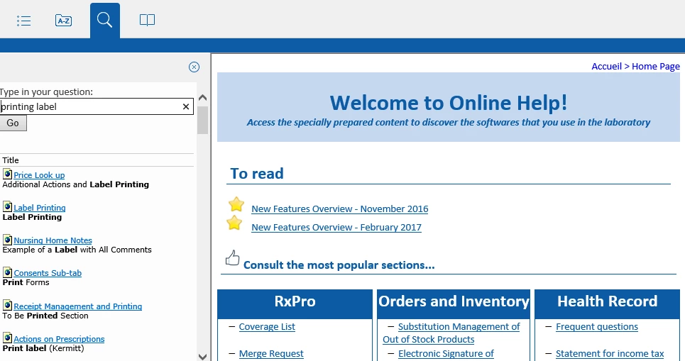

Here is the differences between the version we have locally VS the one on the server
Local version
Server version

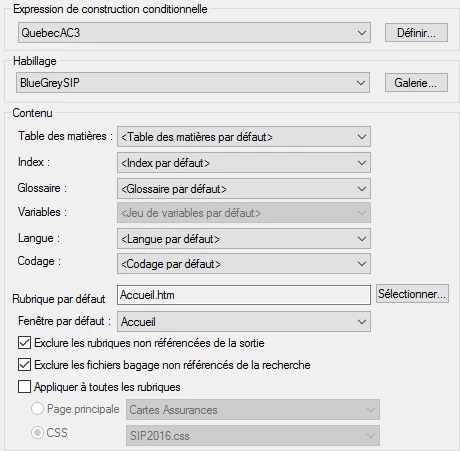

It was the default Window that wasn't configured to show them.
