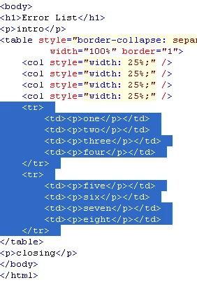

In RoboHelp I created a simple table of 2 rows and 4 columns. I formatted the cells as Normal and looked at the HTML.
The Table Row <tr> and Cell <td> structure is easy to see; Each row begins with
  <tr><td><p>
Between each cell is
  </p></td><td><p>
Each row ends with
  </p></td></tr>
First I `cleaned' my Excel sheet; I used Replace All to replace all commas with a string "COMMA". I also replaced ampersands "&" with the html "&" and then replaced greater-than ">" with "&gt;" and less-than "<" with "&lt;"
Then I inserted columns in the spreadsheet and filled them with the HTML table structure described above. I saved the Excel sheet as a comma-delimited file CSV.
I closed Excel and opened the CSV file with a text editor (Notepad).
I used Replace All to remove all commas (inserted by Excel); then restored the real commas by replacing the string COMMA.
Then I copied the entire contents of the file onto the clipboard, and pasted it into the HTML to replace my dummy rows.
That was it! RoboHelp accepted the transplant and I could format the header rows and set column widths in the normal way.
