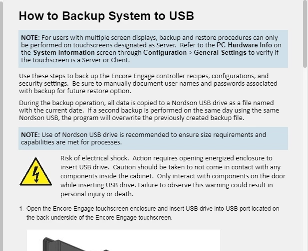

Is there a way to have the title of a warning, along with its icon automatically formatted and recalled (style, variable, etc.)?
For example, can I select some element in RH and automatically get the icon and "WARNING:" (red circled portion of image below) to populate so that I only have to type in the variable text each time?

    GLNT1Author
    Jun 10, 2020 7:34 PM UTC
    Padding and Line spacing doesn't seem to have any effect on my ol.Warning style.  I wanted to leave a bit more space above/below the warning.  I also wanted to close up the line spacing to match that of the normal paragraphs.  Is this not possible?  I tried adjusting Padding top/bottom and Line Spacing with no luck..
    GLNT1Author
    Jun 10, 2020 6:57 PM UTC
    Can you tell me what setting I adjust to make the text align with the top of the icon?  Is this possible with autonumber?
    Actually, the text aligns top when I use it as an OL style.  I'm not sure why I get two level 1s in the Preview, though. It looks fine when I apply the style in a topic.

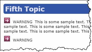

    Jun 9, 2020 8:21 AM UTC
    Not quite as shown as text wrap comes into it when the text gets below the icon.
    What you see below is a P class with Autonumber applied. I think in another recent thread it was done with a list and that will give better control over the gap. I have not played with this style to reduce the gap and maybe that's not an issue.
    For Autonumber, in the Style Editor, duplicate the P tag and name it as required - p.warning for example. In Properties > Autonumber, select the image and then add the text. To make it bold, change the editor to source view and add the property below.
    font-weight: bold
    For Lists, do the same with the OL style.
