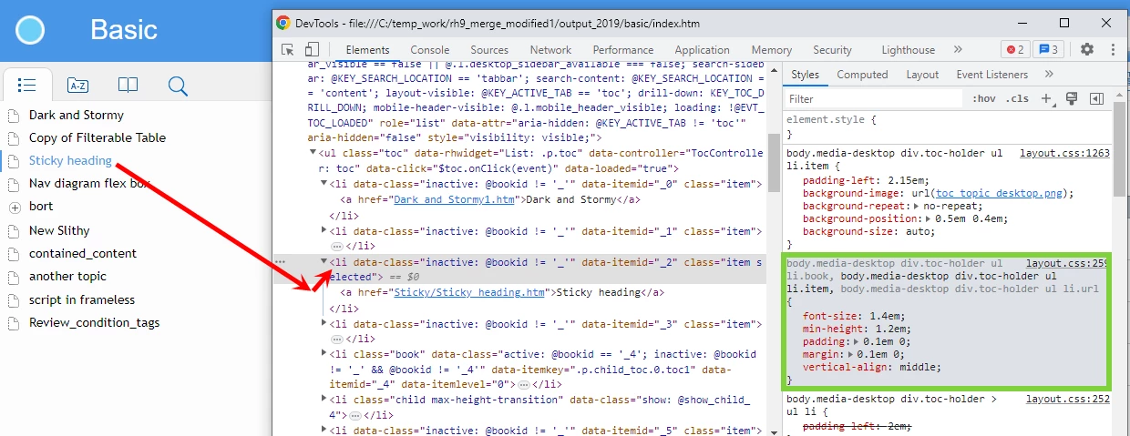

    I don't  have access to RH2022 right now, but you want to right-click on the text in the toc to get to the specific text entry, then you want to go up the hierarchy until you find an element with a font size assigned. In this example we go up one level to find it. You want to add the selectors to your custom stylesheet, add only the font-size property and change the value to what you want. Dont' pay too  much attention to the selectors in my example as they may be very different (for example rh2022 might use dt/dd selectors rather than ul/li selectors) - just find the first level that lists a font-size.
    e.g.
    body.media-desktop div.toc-holder ul li.book, body.media-desktop div.toc-holder ul li.item, body.media-desktop div.toc-holder ul li.url {
        font-size: 2em;
    You will probably need to repeat this process for the index tab, and also for tablet and mobile sized windows.
    I'll try to have a look at RH2022 tonight, but I have some very tight deadlines right now.
    Apr 27, 2023 2:06 AM UTC
    I forgot to add a screenshot to illustrate what I mean:

    @Amebr, thank you very much for the detailed instructions. I will try this.

    I was hoping you would say it was a frameless skin as they are so much more customisable. What you want is in the skin editor for frameless.
    For responsive skins the method is to generate an output and right click what you want to customise, then click Inspect or Developer Tools. Unfortunately I haven't been able to identify what to customise. The you create a CSS and add it to user assets.
